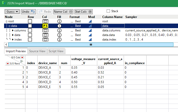

JSON Import Wizard with Pandas Values and Headers
Hi,
I am trying to import a JSON file as a Data Table, and having difficulty finding the correct settings in the JSON Wizard.  Does anyone know the correct settings to use?  I am using JMP 18.0.1.
Example JSON

Desired Data Table

Re: JSON Import Wizard with Pandas Values and Headers
Right-click and try the pandas split option.Right-click and try the pandas split option.
Very nice.  Thanks!
