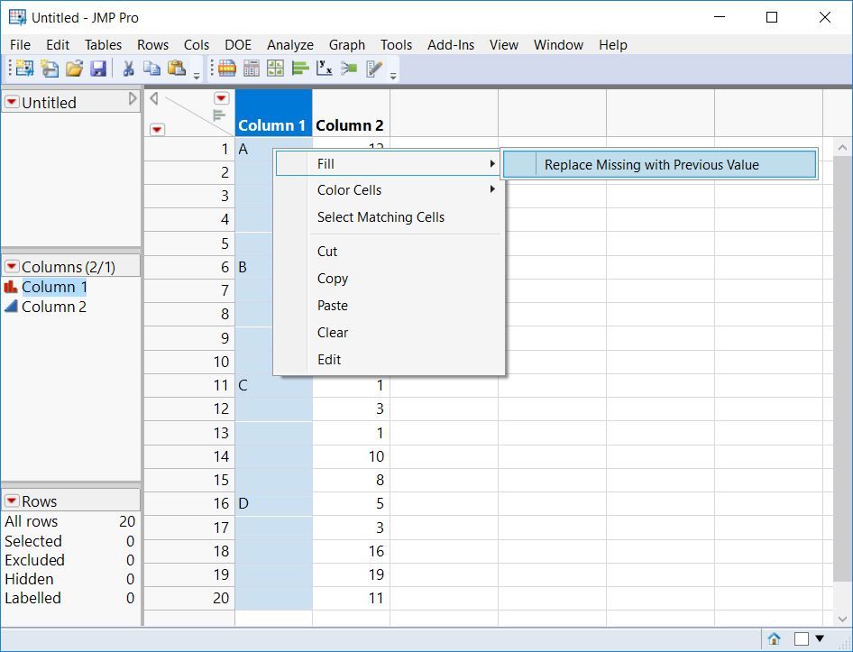

You have a script that will do the job, but there is an interactive solution as well. Select the column that needs the replacement so that all rows are selected. Right-click in the data grid of that column and choose Fill > Replace Missing with Previous Value.
Dan Obermiller

Re: How to replace empty rows until next entry (and continue)?
I don't know the JSL code behind the interactive solution. That should be fine since you have multiple options there.
I do know that the interactive solution, like some of the scripts, can be applied to multiple columns simultaneously. Just select all of the columns and right-click, choose the Fill option.

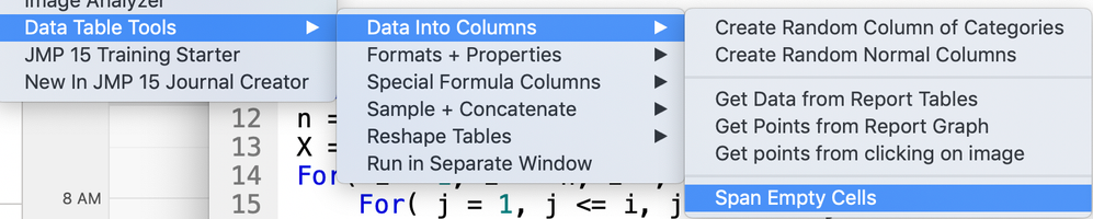

there is a really fantastic add-in, a must-have called data table tools
there is an interpolation tool in there that does this, and so much more. Plus its much faster than the formulas on big tables.
