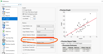

Level VI
Re: degree of "faded" for "unselected faded"
Maybe I'm missing something with the other posts, but can you not just set the level in the JMP Preferences?
Jordan
hogi
Level XIII
You are right.
Actually, the direct answer to my question :)
