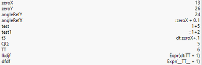

After creating the first two variables, I'd like to make my angleRefY and my angleRefX variables be offset from zeroX and zeroY by a static number. I've tried to do this a few different ways as you can see below.
The only way that produced a number was this script, but then the variable becomes 6 instead of QQ+1, so they still aren't linked.
dt << Set Table Variable("TT", dt:QQ + 1);
Does anyone know how this could be done? Ideally zeroX = some number, zeroY = some number, angleRefX = zeroX + some number, and angleRefY = zeroY + some number as a dynamic reference.

Here is a simple example.  Your code was close, just needed to understand that all Table Variables are character, and also, all you need to do to reference a table variable is to use :QQ, since the dt is already the object of the message.
names default to here(1);
dt=new table("Example", add rows(3),new column("Sample", values([1,2,3])));
dt << new table variable("QQ", 42 );
dt << New Table Variable("TT", num(:QQ) + 1);
Jim

That creates a static offset, I should have been more clear that the goal is a dynamic offset. For example, if QQ gets reassigned to 43, the goal is to have TT resolve to 44 all by itself.
Here is an adaptation of your code that should print whether the variable is actually dynamic or not.
dt << New Table Variable("TT", eval(num(:QQ) + 1));
wait(0);
dt << set table variable("QQ", 50);
if ( dt:TT == 51, show("success"), show("didn't quite work"));

MarkJohnson
Level II
Re: How to reference a table variable inside a table variable
Well there ya go. If it only can store string values, it seems pretty clear that I won't be able to have it be a dynamic reference. Running the table script makes sense. It is just one extra click too, not bad. Thank you for the help!!
