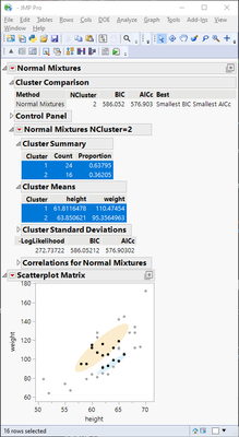

How to record the classification of data points within ellipses in a Scatter Plot Matrix after clustering?
The following JSL code can be used to display a ScatterPlot Matrix after Clustering.
Normal Mixtures(
	Y( :height, :weight ),
	{Mixtures Tolerance( 0.00000001 ), Mixtures MaxIter( 300 ),
	Mixtures N Starts( 30 ), Outlier Cluster( 0 ), Diagonal Variance( 0 ),
	Number of Clusters( 2 ), Go( Scatterplot Matrix( Ellipse Alpha( 0.1 ) ) )},
	SendToReport(
		Dispatch( {"Normal Mixtures NCluster=2"}, "Correlations for Normal Mixtures",
			OutlineBox,
			{Close( 0 )}
		Dispatch( {"Normal Mixtures NCluster=2", "Scatterplot Matrix"}, "101",
			ScaleBox,
			{Min( 59.68 ), Max( 179.498666666667 ), Inc( 20 ), Minor Ticks( 0 )}
I need assistance with the following two questions:

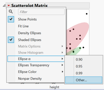

(1) How can I set the Ellipse α to 0.4 in the JSL code?
(2) I would like to record the points included in the Ellipse with an α of 0.4, where the points within the red Ellipse are labeled as 1, those within the green Ellipse are labeled as -1, and the points outside both Ellipses are labeled as 0. This is similar to saving clusters in a Table, but instead, I want to record the points included in the Ellipses. How can I add this functionality to the JSL code?

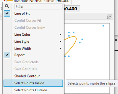

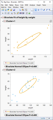

but this won't let you get the points. To get this you can use Fit Y by X platform (use cluster as By column).
This is one place where I know you can select the points inside of the ellipses

biv = dt << Bivariate(Y(:weight), X(:height), By(:Cluster), Invisible);
biv << Density Ellipse(0.4, {Select Points Inside});

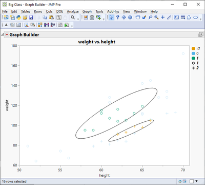

// Just for visualization purposes
gb = dt << Graph Builder(
	Size(653, 491),
	Show Control Panel(0),
	Variables(
		X(:height),
		Y(:weight),
		Overlay(:Cluster, Overlay Encoding("Style")),
		Color(:Ellipse)
	Elements(Points(X, Y, Legend(3)))
For(i = 1, i <= 2, i++,
	ls = Report(biv[i])[FrameBox(1)] << Find Seg(LineSeg(1));
	xs = ls << Get X Values;
	ys = ls << Get y Values;
	Eval(EvalExpr(
		Report(gb)[FrameBox(1)] << Add Graphics Script(
			Line(Expr(xs), Expr(ys));
//biv << close window;
