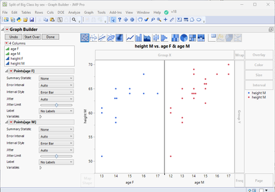

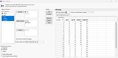

You will need to split the data by Part Number into 2 separate columns and then add the 2 part numbers on the X axis, side by side.
Then add your Y column.  In my example below, I also added in a reference line after the highest level of the first X axis column.
Using the Big Class data table, with all of the 12 year old females removed, I split by the Sex column.
Here is the graph I created on the split data
Note that the X axis for the females does not have a 12 year old category
Jim

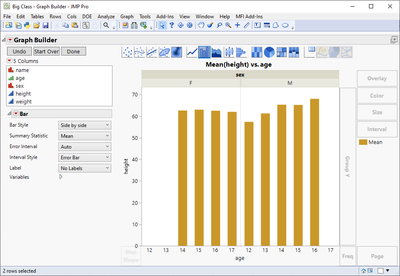

Starting from this

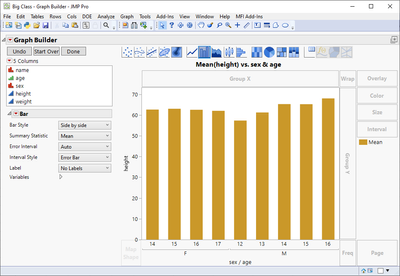

If you don't mind on missing out of the X-group you can also add both columns to X-axis

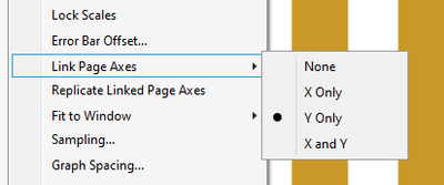

You can also use Page and not link X-axis and then move X-axis to "hide" those missing values
