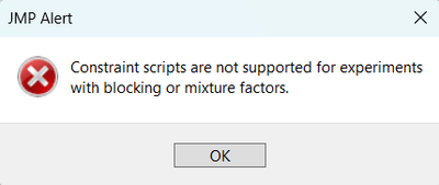

Indeed, if you try to use blocking with constraints when augmenting the design, you'll receive a warning message :
You could generate the design you want in two steps :
  1. Generate the new runs without blocks first with the Augment Design platform,
  2. Use these new runs as Candidate set in the Custom Design platform (without changing the assumed model) to create the blocks, and add a blocking factor in the "Factors" panel. Check the option "Include all selected covariate rows in the design" if you want to make sure that all previously generated runs in step 1 will be present in the final design with blocks.
Make sure you have enough runs when first augmenting the design so that the block creation does not create new runs.

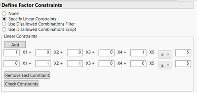

I tried to reproduce a Custom design with 5 continuous factors and 2 linear constraints :
Generating this design creates a datatable with a "Constraint" script : 
{1 * :X1 + 1 * :X5 <= 5, 1 * :X2 + 1 * :X3 >= 5};

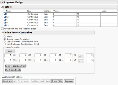

When augmenting this Custom Design with the platform Augment Design, the "Constraint" script is taken into consideration :
So I suppose that if you have started with some data, the "Constraint" script was not present in your datatable, so JMP is not able to use this linear constraint and take it into consideration for the augmentation.
You could try to set this script yourself to "force" JMP to respect your experimental space constraints.

I realized my constraints are removed if I try to use blocking! (Use block for new runs). If I don't do that, you are right, the constraints are present.
