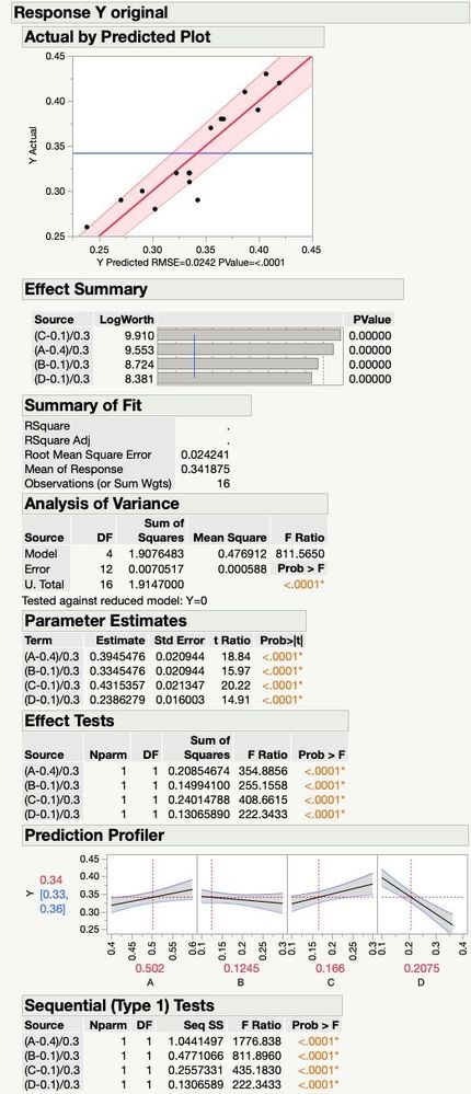

It looks like the problem is that you are not analyzing the data with a Scheffe mixture model. Look at the Analysis of Variance table. You will see a message there that says "Tested against reduced model: Y=0". That means you are fitting a no-intercept model. What you SHOULD see for a mixture model is "Tested against reduced model: Y=mean".
So, what went wrong? Most likely someone did some rounding when entering the values of your four components. Create a column that is the sum of your four components and you will likely see something that is different than 1. The sum must be 1 EXACTLY for JMP to analyze the data as a mixture. Once that is fixed, try re-fitting the model. Come back here if you still have questions at that point.

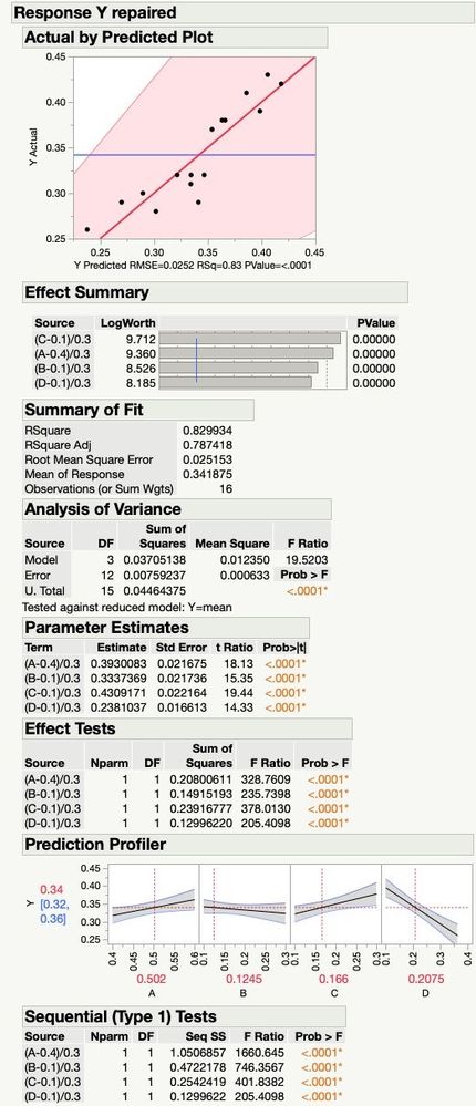

Thanks Dan, it turns out that one of the rows did not sum to 1.0.  When I repaired it (changed one proportion from 0.47 to 0.48), then the result made me more confused.
The sums of squares (sequential and adjusted) changed hardly at all, including the error SS in the ANOVA. But, Model SS in ANOVA is nowhere near the same.  The total sums of squares for the sequential SS don't sum to the value in the ANOVA in the repaired analysis like they did in the original.  Somehow 1.87 units of SS have gone somewhere that I don't see.
The confidence intervals in the response profiler are the same, but not in the Y Actual by Y Predicted plot. The parameter estimates are nearly unchanged.
The attached images show the differences, one is entitled "Response Y original" the other is "Response Y repaired".  You can see that the message in the ANOVA table is either "Y=0" or "Y=mean".

You will only need to be concerned with your Y repaired.
The Scheffe mixture model cannot be interpreted like a typical regression model. It looks like there is no intercept in the model, but there is. The intercept is included with the main effects. The interpretation is what matters. For example, the main effect parameter estimates are actually the height of the response surface at the pure component vertex of the respective components. In other words, it is the "effect" of the component plus the overall mean. That is why the ANOVA has the message "Tested against Y=mean". So the type I SS will not add up properly because of the mean being involved in all of the SS of the main effects.
The confidence bands on the observed versus predicted plot are correct for the Scheffe model. They are much wider because of the inherent multicollinearity caused by a mixture. When factors are correlated (as they are in a mixture), that leads to an inflation in the variance of the parameters. Thus, the error bands will be much wider on the model fit. The prediction profiler will look better because that is a confidence interval on the prediction, not the significance of the parameters.
