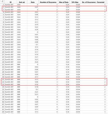

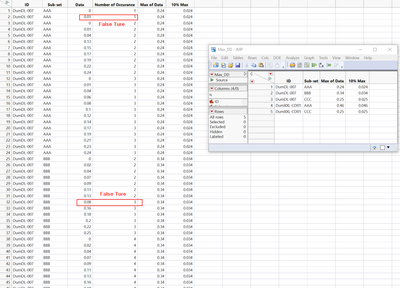

 I am trying to find out number of times alarm trigged. I have created a column "Number of Occurrence" based on simple logic --  If Data in Row () > Row()+1, trigger re-seted. But I am getting lot of false alarm, as seen in the image. The new login I want to implement -
If (
(Row() - Row()+1) >= Abs(Max(Data))/10, Reset the trigger, otherwise live it as it is

I am able to do it in a bit log way, like making summary table and then adding column from summary table and then comparing each value with new column. It works fine but making my script slow.

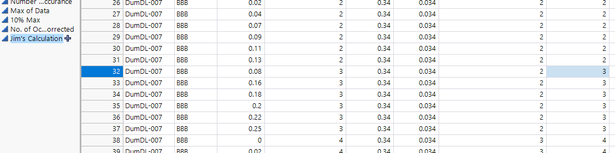

There is a discrepancy with your No. of Occurrence - Corrected.  On Row 32, I believe .13 - 08 results in .05 which is greater than .034, which should increase the number of occurrence.

I have added a column - "No. of Occurrence - Corrected".  Which shows the correct (desired) results.

It is not working. Somehow I am not able to implement - "Col Max(:Data , Group by{ID, Sub-set})" something like this.
I am able to call value from summary table to the column formula of main table, it is better than my original solution.

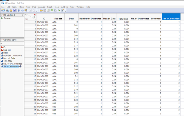

Your implementation of an additional occurance is also not applied until the row after it is discovered.  Therefore, using your formula has to have a little trickery put into it, to not apply the change until the next row is processed.  Below is my formula that I used for "Jim's Calculation" column
If( Row() == 1 | :ID != Lag( :ID ) | :"Sub-set"n != Lag( :"Sub-set"n ),
	hold = :Number of Occurance;
	applyRow = 0;
If( :Data - Lag( :Data, -1 ) >= Abs( Col Max( :Data, :ID, :"Sub-set"n ) ) / 10,
	applyRow = Row() + 1
If( Row() == applyRow,
	applyRow = 0;
	hold = hold + 1;
hold;

Hi @txnelson, It worked. many thanks.

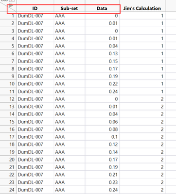

1. Your formula is working. But it is taking "No. of Occurrence" as a input for "hold" in row number 2. Is there any way we can bypass that column. (let say, I do not have my original "No. of Occurrence" column!). Can we get correct No. of Occurrence based on just first 3 columns ? I do not want to depend upon that columns, if tomorrow I found some other type of false alarm, not covered here !

I understand that my starting point for for No. of Occurrence is not same every set of data. (Some times it is 1 and sometimes it is 2 and so on). So it is not possible to eliminate that column fully. But just as dummy column I can replace first "hold =1" and then it works as a counter.
