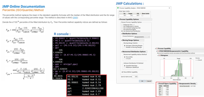

Hi, I would like to figure out how JMP 16 Calculate Ppk in non-parametric method. So I calculate Ppk in R code with the formula in online documentations, but the results are very different. Could anyone help me to understand if it is my calculation error or the documentation?

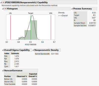

Sorry I post wrong JMP results, the JMP results are as follow:

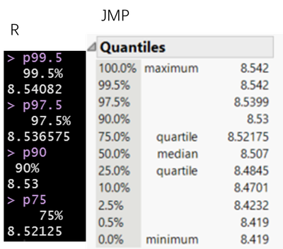

JMP基础统计的结果有吗?看看分位数的结果是否一致。如果公式本身没有问题的情况下。

你好,我简单用R计算了一部分百分位数,和JMP略有差异,但Ppk计算结果差别太大了(R:2.026, JMP: 1.678),可能不是百分位数计算方法造成的误差.

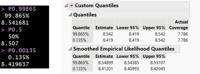

考虑到基础统计量计算结果的不同导致最终结果的不同。不知道是否方便讲JMP中基础统计模块的0.99865/0.00135的结果显示一下。方便和R做对比。
具体的方法可在红色三角形中选择option-->客户定制。

Sorry for reply so late, I calculate the P0.99865 and P0.00135, the result from JMP and R are still very close.
