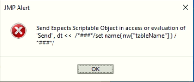

I still have an issue at this level:
dt << set name( nw["tableName"] );
The error message I get is here below
Could you please help me solve it?
Thanks again,
F
jthi
Re: How to prompt user to name SQL query output data table and add date and time to filename?
Most likely execution of your script finishes before the New Query(.
Try running the query in foreground instead of background OR use modal before query to get values from user and use postquery script to change the name after query finishes.
-Jarmo
FabioSaragoni
Level II
Executing the query in foreground solved the issue!
