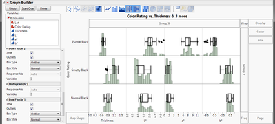

Hi everyone.
Is there a way in Graph Builder to place the box plot on top of the histogram - but within the same facet / cell?
I broadcasted right click > Add > Box Plot.
Appreciate the help.
- Randy, JMP newbie

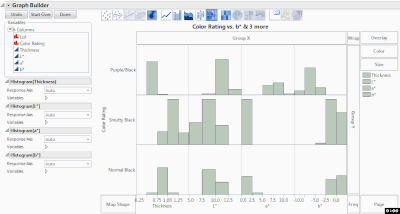

No apology needed since it was my confusion. If you use 'Horizontal Layout' rather than "Stack', JMP seems to do a better job in resizing the display boxes to remove the extraneous space:

If you have a table with a column containing a continuous variable (shown by the little blue icon next to the column name), dragging that variable to the 'X' drop zone of Graph Builder should make a single histogram like the ones you show above. Then if you right click in the cell, you should see 'Add > Boxplot'. Having X or Y grouping variables like above does not change this behaviour.

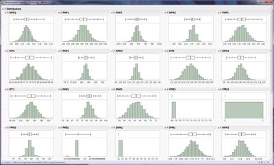

I am making an assumption a bit different than Ian.  I am assuming that what you mean about "On Top Of" is Above the Histogram.  While Graph Builder can not do that, you can do that using Distribution, and then either using the Arange in Rows, as shown below, or by scripting a Sheet Box, you can approximate what you want:

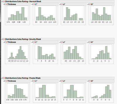

I believe that's how I achieved the original graph (fig. 1).
I was hoping to place the box plots above each histogram, like the ones shared by Jim.
I also tried the distribution platform then broadcasted arrange in rows (3) and Stack but it's taking too much space (fig. 2) unlike the output in the Graph Builder where the graphs are (can be) neatly compacted and adjusted.
