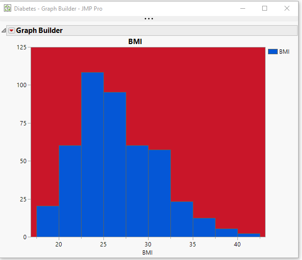

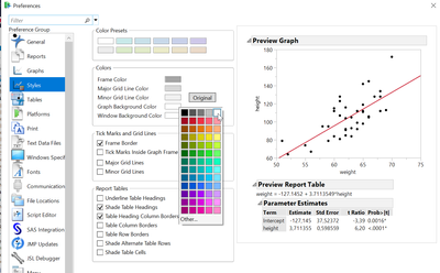

The Graph and Window Background Colour should do the job
Fabrice_L
Level II
Re: How to permanently change the green color and all JMP graphs ?
Thanks for your answer, but this is not the solution. This panel permits to change (for example) the color of the background of a graph, or the color of the background of the window; this works and affect the graph builder (I've tried, see attached image), but the green color of the histogram.
