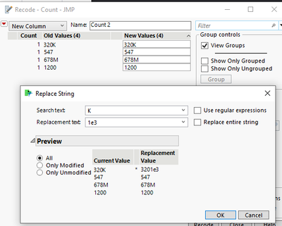

I think Recode can do this:

My suggestion would be to use Recode and if you need the script you can get it from the Recode platform:
