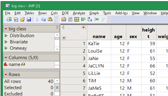

The big win on a lot of the ways you might do this will be to use the Begin/End Data Update as @jthi showed. Here's another way to do it:
dt = Open( "$sample_data/big class.jmp" );
dt << Begin Data Update;
For Each Row( dt,
	dt:name = Substitute( dt:name,
		"A", "a",
		"E", "e",
		"I", "i",
		"O", "o",
		"U", "u"
dt << End Data Update;
Lower case vowels.Lower case vowels.
Craige

Craige_Hales
Re: How to perform "find & replace" in specific a column using JSL script?
@DonMcCormack
For Each Row( dt,
		"A", "a",
		"E", "e",
		"I", "i",
		"O", "o",
		"U", "u"
Craige
Thanks @Craige_Hales. Looks like the makings for a good Challenge question.
