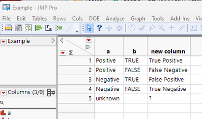

txnelson
Re: How to pass columns as arguments for a function
Here is one way to handle this
Names Default To Here( 1 );
dt = New Table( "Example",
	Add Rows( 5 ),
	New Column( "a",
		Character,
		"Nominal",
		Set Values( {"Positive", "Positive", "Negative", "Negative", "unknown"} )
	New Column( "b",
		Character,
		"Nominal",
		Set Values( {"TRUE", "FALSE", "TRUE", "FALSE", ""} )
my_function = Function( {name, col1, col2},
	dt << New Column( name, Character );
	Eval(
		Eval Expr(
			Column( dt, name ) << Set Formula(
				If(
					as Column( Expr( col1 ) ) == "Positive" & as Column( Expr( col2 ) )
					 == "TRUE", "True Positive",
					as Column( Expr( col1 ) ) == "Negative" & as Column( Expr( col2 ) )
					 == "TRUE", "False Positive",
					 == "FALSE", "True Negative",
					 == "FALSE", "False Negative",
my_function( "new column", "a", "b" );
