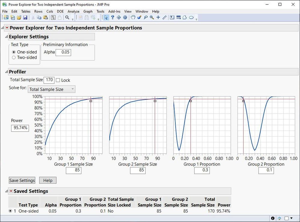

If I know my parts have a 30% failure rate, how many parts do I need to inspect to be 95% confident I will find at least one failure?  Assuming I made a process improvement and want to see if my failure rate decreased from 30% to 10% w/ 95% confidence, then how many parts do I need to inspect?  I think JMP can give me these answers through the DOE>Sample Size Explorer>Power wizard, but I'm not exactly sure how to use this script to get the answers to these pretty basic sample size questions.

Have you seen the documentation for the Power for Two Independent Sample Proportions?

Hi Mark, Thanks for the quick response as this does show me how to use the nice sample proportion wizard for this type of thing.  Taking a slight step back from my above question, let's say it takes 4hrs to inspect my part to see if it will fail.  I need to find a failure so that I can do some failure analysis work, but management wants me to give them a estimate of time for how long it will take to inspect parts before I actually find a failure.  Let's assume a historical failure rate of 30% rate and I want to be 95% confident I am giving management a good estimate of time.  How many parts should I anticipate inspecting before I find a failure?
