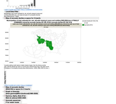

How can I change the default settings of journals so that the boxes of an outline (outline boxes and other text, list, data filter, etc...boxes) default to horizontal positioning? Right now, when I build an outline the boxes position vertically and build sequentially from left to right, instead of positioning 'flat' and building 'top-down' like layers of a cake. To change this, I'm having to go into 'properties' within the journal and manually change each individual box once created, which is cumbersome. I didn't see anything in JMP 'preferences' but might be missing it. Thank you.

How are you adding items to your journal? Could you provide some examples of the incorrect layout?

Here is a small example. The "local data filter" box below the map. I've changed the rest here to match what I'm looking for, but that one box resembles the way all the boxes align when I add an outline item.

I add items: 1) using the cmd+j shortcut, 2) the "save to journal" dropdown from red arrow, and 3) just click-and-dragging to the journal. Same results.

When right-clicking, it is called "outline close orientation"
