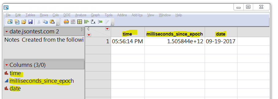

The json support may have been added after 13.0. I think the file you are getting is probably equivalent to using "text" rather than "json".
open("http://date.jsontest.com/", "text")
produces this table:
JSON data, not split up very wellJSON data, not split up very well
in JMP 13.2, using
open("http://date.jsontest.com/","json")
I get a much more useful table:
JSON data, split into columnsJSON data, split into columns
I think if you specify "text" you'll probably get the table you see from File->Open. I hope you can upgrade to 13.2 and take advantage of the better JSON import.
