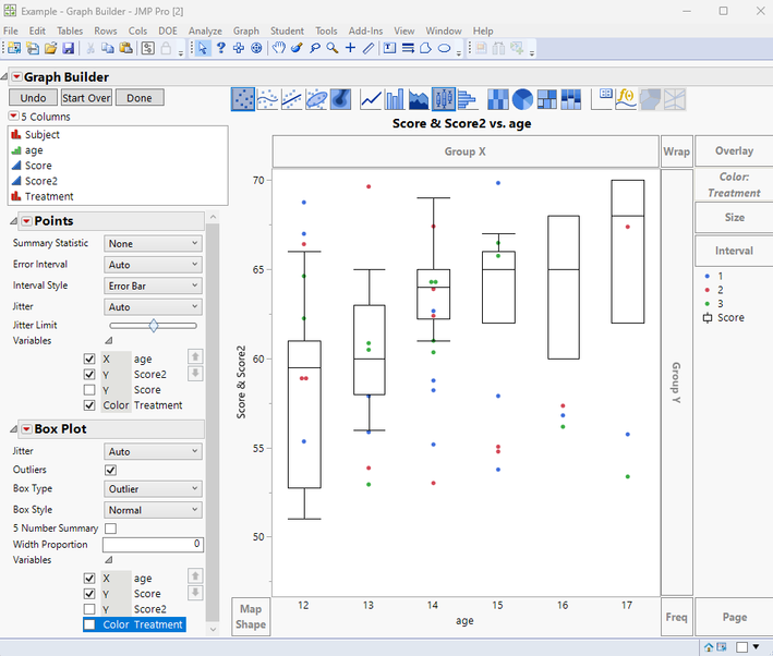

I have data from two studies (#1 and #2), each study had four ages of subjects (A, B, C, D) and one continuous result (score). Study #2 also has treatment groups (x, y, z, etc). I am trying to make a graph to compare the two studies. Ideally, the graph includes box plots of age (x-axis) and Score (Y-axis) ONLY FROM STUDY #1. And then overlay the scores from study #2 as individual data points onto the correct box plot for that subject's age. Finally, those data points will be color-coded based on the treatments in study #2. My data sheet has the data from both studies with columns for Study, Subject, Age, Treatment, and Score. I know how to add data points, color codes, etc but I am having trouble making graph builder only pull from study #1 for the box plots and only pull from study #2 for the data points. Do I need to change how my datasheet is set up? Or is there a way to specify in graph builder which rows/variables to include for each section?

See if this works the way you want.

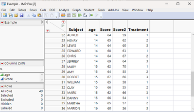

Basically, I took the first data table, and added a new column that I called Score2, and placed the scores from the second study into that column.  I also added a new column Treatment and added in the treatment group for each subject.
To create the graph, I dragged Score and Score2 to the Y axis, and Age to the X axis.
I dragged Treatment to the Color drop area
I then right clicked on the graph and selected Add=>Box Plot
Then I turned to the Properties area on the left for the Control Area.
For the Points, I clicked on the gray triangle next to the Variables listing to open the choices available for the Points and unselected the Score variable, because your request is for the Score values are not to be displayed as points.
For the Box Plot, I opened the choices and unselected Score2 and Color Treatment
Jim

This works great and your explanation was very clear. Thank you!
