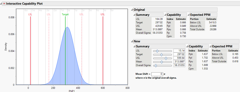

This suggestion is not related directly to your question... but if you have access to the raw data, you could check if Interactive Capability Plot would be useful
Names Default To Here(1);
dt = Open("$SAMPLE_DATA/Semiconductor Capability.jmp");
obj = Process Capability(Process Variables(:PNP1), Individual Detail Reports(1));
obj << {:PNP1 << Process Capability Analysis(Interactive Capability Plot(1))};

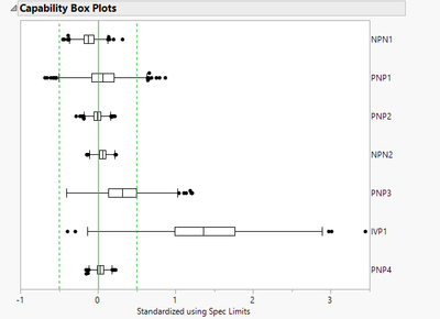

Also Process Capability platforms Capability Box Plots can be helpful (as can the whole platform Process Capability (jmp.com))

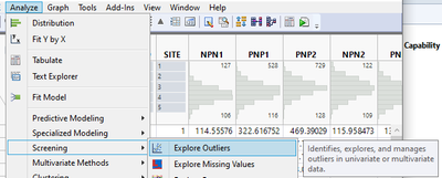

You could check out Explore Outliers platform
There is also good blog post series Outliers Episode 4: Detecting outliers using jackknife distance
