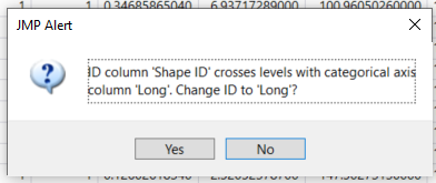

The Hurricane tracking example needs a linking identifier between the shape file and dbf file. I cannot parce how to make a similar function with my data as mine are running time series of point through time (i.e. each point has a uniqe identifier), not strict boundaries of space like counties. I think my approach is wrong. There must be a way to get a background map overlayed on my points using the state plane or lat. long. coordinates that I have. When I build a bubble plot with:
x = lat
y = long
ID = shape ID
Time = Time int
the program gives me the following error:
If I do a simple bubble plot without "ID" and attempt to put a detailed earth map on the background it fails.... The axis labels revert to an odd scale and I no longer see the points.

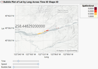

@Frogger  cool data! People or fish? Tiny little GPSs?
Be sure to change the character lat/lon to numeric continuous as shown. Don't convert to numeric without also specifying the format or it might become missing values. I'm not a bubble plot user, so I may have missed some cool features...maybe someone else can point them out. You can right-click the speed slider and change the right-end limit to be much bigger and make the animation go a bit faster.

Particle model data reacting to a hydrodynamic flow model.... Fake fish swimming through a modeled river and responding to parameters of flow with behaviors that have been coded. Attempting to match them up to telemetered data to show we can model fish behaviors and migration.
Duh! I needed to set the column format to interpret it as lat. long.... Thank you for showing me the error of my ways. I knew there was a simple way. I will evaluate tomorrow when I have access to the data source again. Wondering how your street maps read it so quickly. Perhaps you have already downloaded the file?
