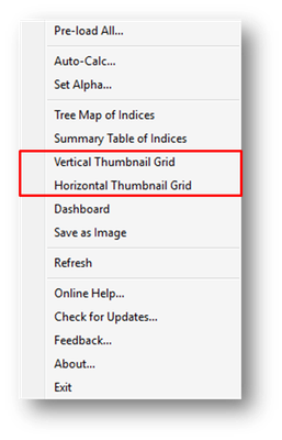

Version 3.00 of the add-in introduces a thumbnail previewer.
The thumbnails can be arranged vertically or horizontally.
The vertical arrangement is designed to sit next to the main window whilst the horizontal layout is intended to fill the full screen.

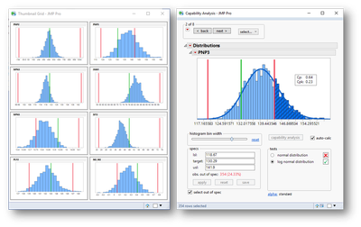

Hover over a thumbnail to view Cp/Cpk indices
Click on a thumbnail to view in the main window
