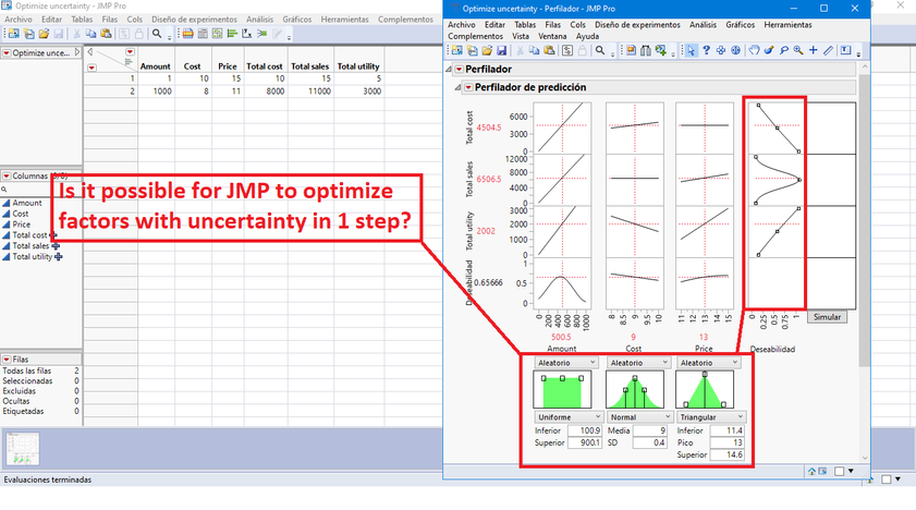

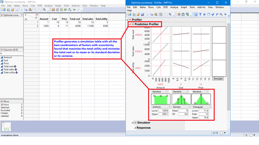

A question: will it be possible for the profiler to find the best combinations of factors with uncertainty when performing a simulation, which maximize the total utility and minimize the total cost, generating a table of the best combinations found? For example:

Your first screenshot of the Prediction Profiler does not show the Desirability Functions. These functions are used to optimize settings across all the response goals and importance settings. That action usually occurs before simulation to assess capability.

I am happy to greet you! Thank you for the observation... I would like to know if it is possible for JMP to optimize the factors with uncertainty in 1 step.

You optimize the mean response using desirability functions. The uncertainty is presented as a confidence interval for the response. You then use simulation with injected variance for each significant factor. You represented the anticipated uncertainty or degree of control through the specification of the injected variance. The distribution of simulated responses is evaluated against specifications.

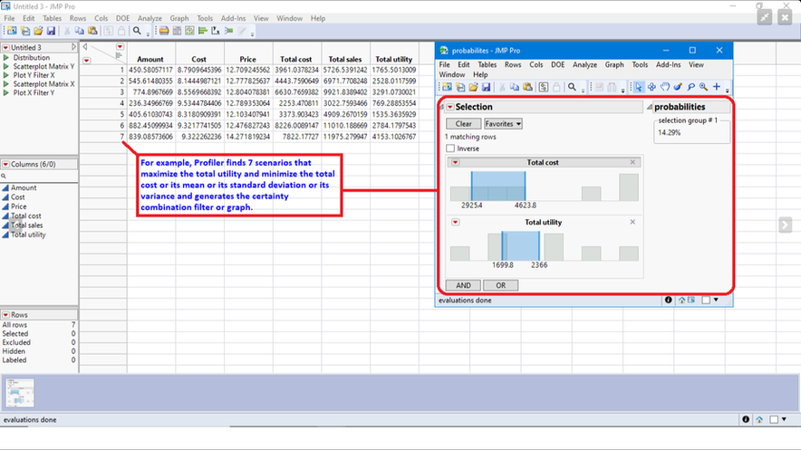

I am glad to greet you, the uncertainty graph with the filters that you created work very well!!!....one question: will it be possible for the profiler to find the best combinations of factors with uncertainty when carrying out a simulation, which maximize the usefulness total and minimize the total cost, generating a table of the best combinations found? For example:

You only need to use desirability functions with the selected model in the Prediction Profiler to optimize factor settings.

In this case, how could I do it?
