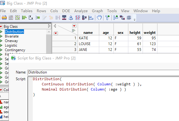

How to open this "Big Class" file with another JSL and directly open the "Distribution "JSL this file to enter the edit state?
Notice not running this "Distribution "JSL?
Give the specific code, thank you!

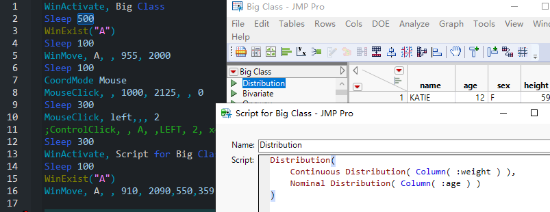

A script implementation of AutoHotkey is used.
Run Program( executable( "I:\00\AHK\AutoHotkey.exe" ), options( {"I:\E\test.ahk"} ) );

I don't think there's a way to call up the built-in dialog box for editing table scripts, but this would get you close. You'd need to add a save button if you want to save the edits back to the table.
jsl = dt << Get Script( "Distribution" );
nw = New Window( "Script", <<Modal, Script Box( Char( Name Expr( jsl ) ) ) );
