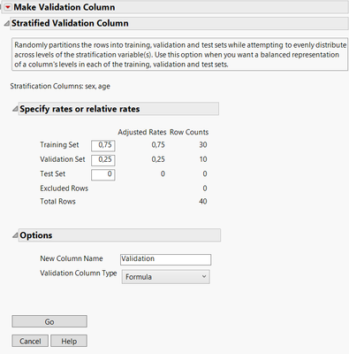

1. Create a validation column formula (here on the Big Class dataset):
2. Use this formula in the model :

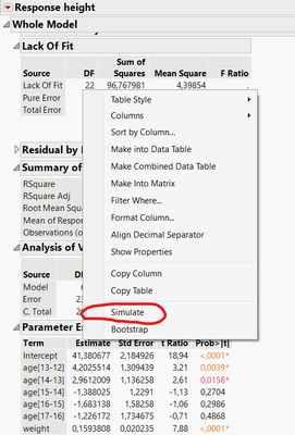

3. Depending on where/what you would like to have repetitions of the model fitting, you can right click on the metrics/estimates you want to repeat and click on "Simulate" (in my example I'm doing it on the "Parameter Estimates" panel values) :
You can specify the number of samples you want and fix a random seed (if you want reproducible results) :

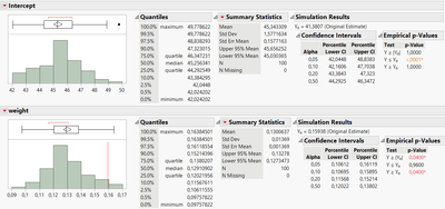

4. After clicking on "OK", the model is fitted 100 times by varying the training and validation sets (according to the stratified sampling formula), and you directly have a summary table (see example attached) with the 100 results of the models, where you can then display the results graphically with the Distributions (script automatically generated in this table) or Graph Builder platforms (example here with the Distributions platform, on the parameter estimates for intercept and weight) :
You can create these steps very easily, and then use the log to copy the scripts generated in order to automatize the steps/analysis.

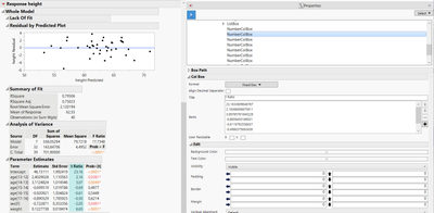

But I don't see an option to specifically select some columns from this panel report. Looking at the properties, I would have to specifically ask to not display and export in the new datatable a certain NumberColBox, for example :
Maybe a more advanced Scripter user may help for this question (If I understood it well). Or it may be more simple in the script to directly add some code to remove non-useful column based on a specific property (name, index, ...). There are also interesting answers on this topic here : Solved: Script to export AIC into new data table - JMP User Community
