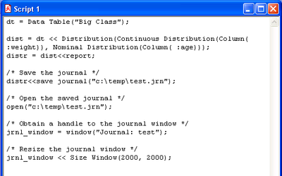

Unfortunately, neither Current Journal() nor Maximize Window were available in JMP 4.  You could try using the Size Window command to resize the journal window to x pixels wide by y pixels high.   You will need a reference to the journal window to make this work.  In JMP 4, to get a handle to the journal, you had to save it then re-open it.  Here is a simple example:
