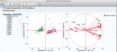

I am fairly new to jmp and was wondering if there was a way in which I could label variables of the same cluster group on a PCA scoreplot (or any other plot involving PCA if that helps). I have already completed a cluster analysis and decided on the amount of clusters I am using, and have saved these cluster groups to my datasheet.
Many thanks for any information provided
Edit: I am aiming to highlight all the different cluster groups in different coloures, i.e. all group 1 red, all group 2 green group 3 blue and so on

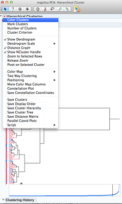

When you do your clustering go to the red triangle and choose color clusters.
5786_Screen Shot 2014-03-21 at 9.27.05 AM.png5787_Screen Shot 2014-03-21 at 9.27.28 AM.png5788_Screen Shot 2014-03-21 at 9.27.49 AM.png
Re: How to mark same cluster groups on a PCA scoreplot
Thank you very much. I had seen that and thought I clicked on it, but obviously not!
I ended up just clicking on each of the variables on the plot and selected 'high all matching cells' and completed it that way, waste of my own time!
