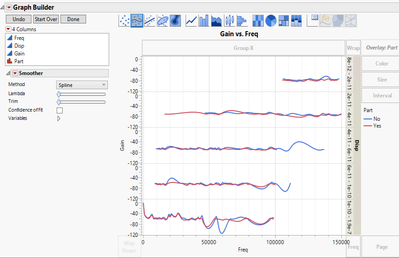

Hi folks,
I have the following dot plot overlay. The plot looks broken at certain frequencies since the dots are not connected to each other. The blue plot has two parts and the red plot has three parts. I would like to plot the overlay with line instead of dots.

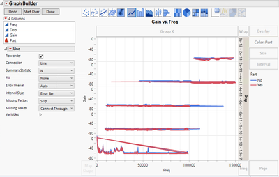

For example, the following plot (not from me) can plot the overlay with line plots shown below. The blue plot and red plot both are lines for each individual part instead of the dot plot that I have in the above.
I am attaching a data table and could any one help advise how we can make the line plot similar to the above, or if there is any JSL can enable the above plot. Thanks.

I think you are trying to make 5 lines here, 2 blue and 3 red. It helps to have a column that indexes which line is which. Your data seems to be 5 series from 5 files, but there is no identifier. It looks like the series repeat every 4800 lines, so I added a "File Number" column that labels the 5 series. Then that new column is used in the overlay role in graph builder, like this:
Edited data table and graph builder script attached.

You mean something like this?
It's just a line chart but yeah, you need to tick the "row order"
Or may be something like this? Smoother line
