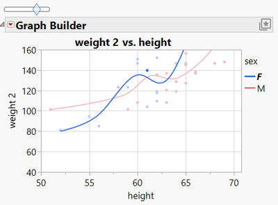

A small appetizer:
Names Default To Here( 1 );
Try( exponent, dt << New Table Variable( "exponent", 1 ) );
dt << new column("weight 2", Formula(:weight ^ exponent )); // added after the comment
New Window( "test",
	sb = Slider Box( 0.7, 1.2, sliderValue, dt << set table variable("exponent", sliderValue) ),
	gb = dt << Graph Builder(
		Size( 437, 413 ),
		Lock Scales( 1 ),
		Show Control Panel( 0 ),
		Variables( X( :height ), Y( :weight 2 ), Overlay( :sex ) ),
		Elements(
			Points( X, Y, Legend( 1 ) ),
			Smoother( X, Y, Legend( 2 ) )

Small typo - change ":weight 2" to ":weight"

Thanks @pmroz for the comment.
I forgot to copy the column formula for manually added :weight2 to the script. -> added now.
