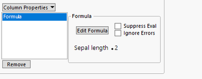

Below is a script to transform the selected columns in a table. This does NOT work, because the expression 'cols[i]' is saved in the column formula instead of the column name.
//Open A Table and select a few columns
dt = Open( "$Sample_data/iris.jmp" );
cols = {Sepal length, Petal length};
//This code does not work
For( i = 1, i <= N Items(cols), i++,
       dt << New Column(
              "2 * " || Char( cols[i] ),
              Numeric,
              "Continuous",
              Formula( As Column( cols[i] ) * 2)
New columns are created with the correct name but this formula:
Solution
