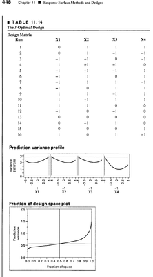

The book is Douglas C. Montgomery, Design and analysis of experiments (2020)
On page 445 ~ 448, Example 11.3, summary is as follow.

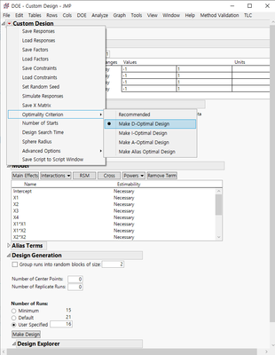

JMP>Custom DOE>
- 4 Continuous factors
- RSM
- 'D-optimality'
- runs: 16
above 4 are my designated values, as per following figure
However, the result is not same to the textbook.

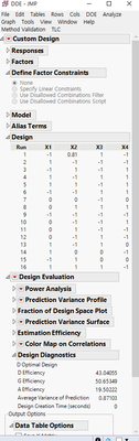

It always includes below decimal Level of the factor(s)., as follows.
Thus there is no identity between the textbook.

Of course there is a way to inform JMP that you have discrete numerical factors, just set up your 4 factors as Discrete Numeric with three levels (-1, 0, 1) :
This will add a constraint during the design generation to only use the three possible levels values for each factor in the design :

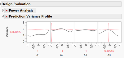

The one I generated with the same model (main effects, interactions and quadratic effects), optimality criterion (D) and run size (16) has a similar prediction variance as the D-optimal design from the book (1,86 vs. 1,80 in the book for the specific setting of factors) :

As experimental points from optimal designs are generated through an algorithm (Coordinate-Exchange Algorithm) and based initially on random points, a part of randomness is present and may lead to different optimal designs, with similar performances and characteristics but different individual experimental values for the factors and runs.
For the "strange" values you can sometimes see (like 0.81 instead of 1, or -0.22 instead of 0), this is due to the design generation process based on initial random values. Modifying the number of starts and the time for each design generation may improve the global optimality of the design found, but you may still encounter such values. This is not a big problem and you can still "round up" these values to more conventional ones (for example, rounding 0.81 to 1), with only a possible little loss in optimality.

Since 2 of the designs (D and I optimal) shows all the Levels are Integer (-1, 0, 1), it could have not been generated by a random manner.
Moreover, the overall performance of the generated Designs in my setting are a lot deficient than the Author's.
Says, for example, Pred Var: 2.2 (mine) and 1.8 (author).
