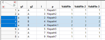

Idea is that we pick the rows where ValidFile is 1 and then open those files. This image demonstrates the calculations for the three different formulas.

Edited my message to rename old variable. We aren't adding up character columns, we are using them from grouping (<byVar>). And we use 1 so we have something that will increase by 1 for each row in the group. It might be a good idea to create different types of formulas by using those functions to make it easier to understand how they work, scripting index also provides some examples.
