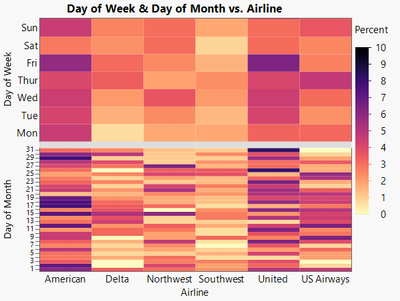

Hm, as a fallback solution one could stack the 2 pieces of information into a single column to get the correct values for both plots.
But I hope that there exists a simpler solution directly via Graph Builder ?

dt = Open( "$SAMPLE_DATA/Airline Delays.jmp" );
New Column( "larger100min",
	Formula( If( :Arrival Delay > 100, 1, . ) )
obj = Tabulate(
	Add Table(
		Column Table( Statistics( N Missing ), Analysis Columns( :larger100min ) ),
		Column Table( Statistics( N ) ),
		Row Table( Grouping Columns( :Airline, :Day of Week ) ),
		Row Table( Grouping Columns( :Airline, :Day of Month ) )
{dt2,dt3}=obj << Make Into Data Table;
obj << Close Window;
dt2 << Concatenate(	dt3,Append to first table);
dt2 << New Column( "Percent", Set Each Value(	((:N - :"N Missing(larger100min)"n) / :N) * 100));
dt2:Day of Week << Set Property(
	"Value Order",
	{Custom Order(
		{"Mon", "Tue", "Wed", "Thur", "Fri", "Sat", "Sun"}
	), Common Order( 0 )}
Graph Builder(
	Size( 526, 448 ),
	Show Control Panel( 0 ),
	Summary Statistic( "Median" ),
	Graph Spacing( 10 ),
	Variables(
		X( :Airline ),
		Y( :Day of Week ),
		Y( :Day of Month ),
		Color( :Percent )
	Elements( Position( 1, 1 ), Heatmap( X, Y, Legend( 14 ) ) ),
	Elements( Position( 1, 2 ), Heatmap( X, Y, Legend( 15 ) ) ),
	SendToReport(
		Dispatch(
			"Day of Week",
			ScaleBox,
			{Min( -0.5 ), Max( 6.5 ), Inc( 1 ), Minor Ticks( 0 )}
		Dispatch(
			"Day of Month",
			ScaleBox,
			{Min( 0.5 ), Max( 31.5 ), Inc( 1 ), Minor Ticks( 0 )}

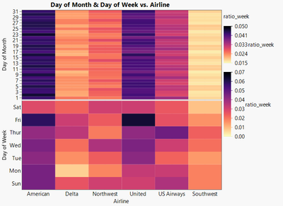

Thanks to a question raised by @dale_lehman :
there is now also a new answer to this post :)
The result is not at all better than with the workaround - but it's now just a single step to get there  ;)
dt << New Column( "ratio_week",
	Formula( Col Number( If( :Arrival Delay > 100, 1, . ), :Airline, :Day of Week ) / Col Number( 1, :Airline, :Day of Week ) )
dt << New Column( "ratio_month",
	Formula( Col Number( If( :Arrival Delay > 100, 1, . ), :Airline, :Day of Month ) / Col Number( 1, :Airline, :Day of Month ) )
Graph Builder(
	Size( 600, 557 ),
	Graph Spacing( 4 ),
	Variables(
		X( :Airline ),
		Y( :Day of Month ),
		Y( :Day of Week ),
		Color( :ratio_month ),
		Color( :ratio_week )
	Elements( Position( 1, 1 ), Heatmap( X, Y, Color( 1 )) ),
	Elements( Position( 1, 2 ), Heatmap( X, Y, Color( 2 ) ) )
