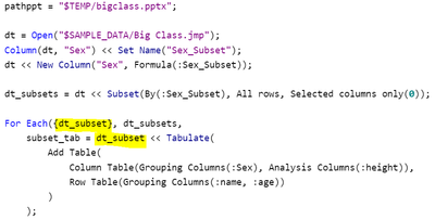

jthi
Re: How to loop tabulated tables and images into ppt slides
If you use Subset with By, you will get a list of tables which you can then loop over
dt1 = {DataTable("Sex_Subset=F"), DataTable("Sex_Subset=M")};
Edit:
Check scripting index for your functions and messages you are using, some of them are incorrect
Names Default To Here(1);
pathppt = "$TEMP/bigclass.pptx";
Column(dt, "Sex") << Set Name("Sex_Subset");
dt << New Column("Sex", Formula(:Sex_Subset));
dt_subsets = dt << Subset(By(:Sex_Subset), All rows, Selected columns only(0));
For Each({dt_subset}, dt_subsets,
	subset_tab = dt_subset << Tabulate(
		Add Table(
			Column Table(Grouping Columns(:Sex), Analysis Columns(:height)),
			Row Table(Grouping Columns(:name, :age))
	tab_pic = subset_tab << get picture;
	subset_tab << Close Window;
	name_dt = dt_subset << get name;
	Close(, no save);
	hbppt = H List Box(tab_pic) << get picture;
	ppt = Outline Box(name_dt, hbppt);
	If(!File Exists(pathppt),
		ppt << savepresentation(pathppt);
	, // append only if file already exists
		ppt << savepresentation(pathppt, append);
Open(pathppt);

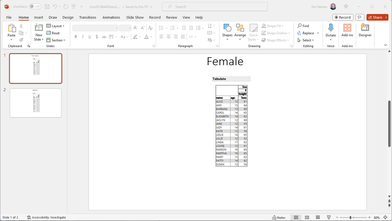

txnelson
Here is a rework of your script that creates the slides
Names Default To Here( 1 );
// Specify the path to save the pptx's to
pathPPT = "$TEMP/UserID16644Slides.pptx";
:Sex << Set Name( "Sex_Subset" );
dt << New Column( "Sex", Formula( :Sex_Subset ) );
// Add value labels so the full value can be used for the slide title
dt:Sex_Subset << Value Labels( {"F" = "Female", "M" = "Male"} ) << Use Value Labels( 1 );
// Subset the tables.  The dataTableList will contain a reference to each table created
dataTableList = dt << Subset( By( :Sex_Subset ), All rows, Selected columns only( 0 ) );
// Loop across all of the tables and create the Tabulates
For Each( {table, i}, dataTableList,
	dt_Tab = table << Tabulate(
		Add Table(
			Column Table( Grouping Columns( :Sex ), Analysis Columns( :height ) ),
			Row Table( Grouping Columns( :name, :age ) )
	// Pull the subset name from the data table name
	theTitle = Word( 3, Char( dataTableList[i] ), "\!"=" );
	// Create the new slide
	hbppt1 = H List Box( dt_tab  << get picture);
	ppt1 = Outline Box( theTitle, hbppt1 );
	// The pptx must exist for the append to be used, so on the first
	// slide it is not appended
	if(i==1,
		ppt1 << savepresentation( pathppt,"PNG" ),
		ppt1 << savepresentation( pathppt, Append,"PNG" )
// Open the powerpoint presentation to see the results
open(pathppt);
Jim

I see. Also, just wondering where did dt_subset came from?
Because as I tried this line of code, dt_subset (dt_subset << Tabulate() )is not found. However, I tried replacing it with dt_subsets, it tabulated the tables 2x (2 tabulated tables for male and 2 for female)
For (i = 1, i <= N Items( dt_subsets ), i++,
		Add Table(
8 REPLIES 8
jthi
Edit:
		Add Table(
	Close(, no save);
Open(pathppt);
-Jarmo
UserID16644
Level V
Hi, I tried converting the For Each loop to For but doesn't get an output
For (i = 1, i <= dt_subsets, i++,
		Add Table(
txnelson
dt_subsets is a JMP list.  what you need is the number of elements in the list.
	subset_tab = dt_subsets << Tabulate(
		Add Table(
Jim
UserID16644
Level V
		Add Table(
txnelson
The variable
dt_subset
is an error, it needs to be
dt_subsets
Jim
txnelson
		Add Table(
	if(i==1,
open(pathppt);
Jim
