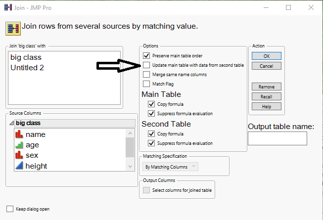

In the Join dialog box, there is a check box, that allows you to "Update main table with data from second table"

Re: join tables without creating a new table
Strange, in my case it still creates a new table.
This creates a new data table per the JMP 18.1 documentation
Data in the original table are updated with data in columns that have the same names. The results are displayed in a new data table.
I think this didn't used to create a new data table. Was this changed recently?
Tables=>Join
always creates a new data table.
Tables => Update does not work for my situation, since it cannot do an Inner or Right Outer Join.
You are looking at the documentation for JOIN DATA TABLES. There is an option when joining tables, to "Update main table with data from second table". This is different from the other function -- UPDATE DATA TABLEs
See the following link for the details: Update Data Tables
