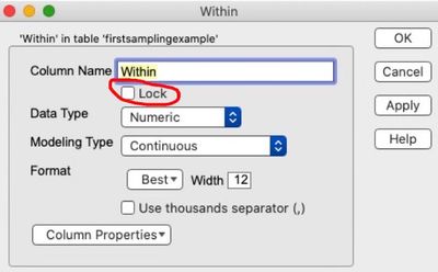

Quickly, right click on column you want to unlock, select Column Info>uncheck the Lock box.
Screen Shot 2023-02-14 at 7.50.00 AM.jpgScreen Shot 2023-02-14 at 7.50.00 AM.jpg
