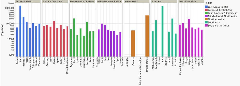

A hint: when I try to “illustrate” the issue using data from the samples folder, it is hard to find a file that has enough complexity to demonstrate the problem. A "light" version of the problem, with Bar charts instead of Box plots:
Open( "$SAMPLE_STIPS/World Population 2017.jmp" );
Graph Builder(
	Variables(
		X( :Country ),
		Y( :Population ),
		Group X( :Region ),
		Color( :Region )
	Elements( Bar( X, Y ) )
