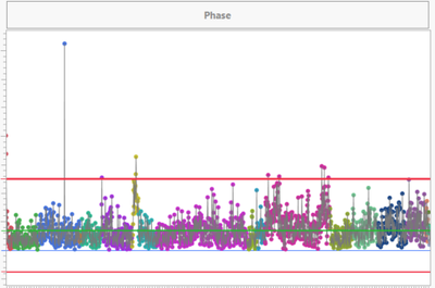

I use the Control Chart Builder platform. In it, I often need to perform the following actions:

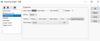

  • Right-click on the Graph
  • Customize...
  • Move "Marker" below "Connect Line"
This way my graph is more visible. But I have to repeat this operation every time. Aren't there any JMP preferences to change this by default?

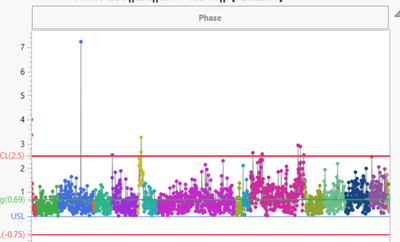

BEFORE
AFTER

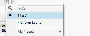

If you have JMP18 you could make a preset and then it is fairly quick to access
Not sure if you can make a platform to use specific preset by default though
-Jarmo

Hello,
Thank you, I guess that will do the job for now, but that would be great if we could also set this in preferences.
