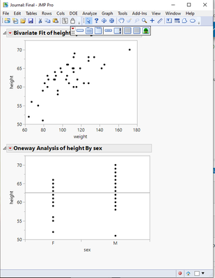

I changed
//create new window
nw = New Window( "Final" );
into making it a journal
//create new window
nw = New Window( "Final",<<journal );
and both of the saved journal entries are properly copied into the new journal

I changed
//create new window
//create new window

Thanks a bunch, txnelson!
On Jmp 12.2, it did not work as is. Opening closed jrn via Open and appending new distribution to it worked.
