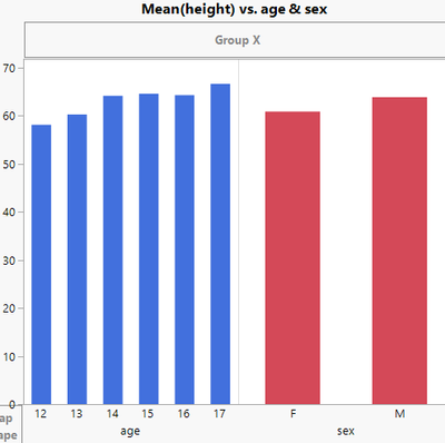

Is this what you are trying to do?
If so, in Graph Builder, you just drag the Age column to the X axis, then go back and drag the Sex column to the right end of the X axis

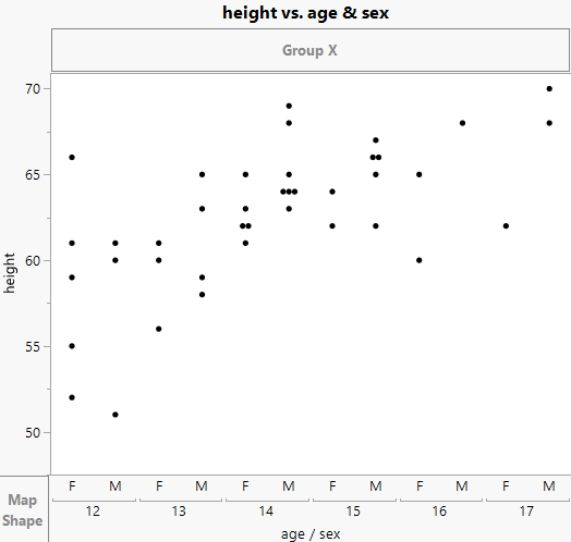

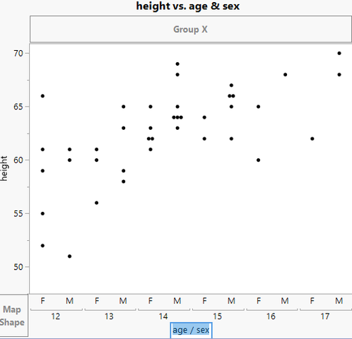

  2. To remove the axis label, I clicked on the    age / sex    to edit it, and used the Backspace key to delete it. txnelson_2-1656655926967.png

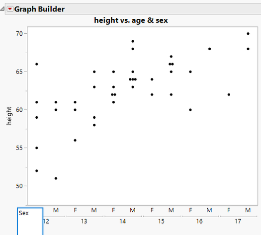

  3. Next I used the Annotate Tool  txnelson_4-1656656026619.png to add the Sex label
  4. After it is entered the mouse can be used to position it exactly where it is wanted.

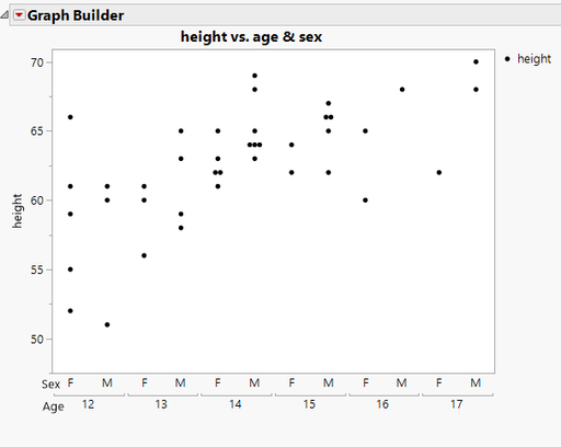

    I then repeated the same step to add the Age label..  The first graph displayed is what the final results were.
  6. The last step was to go to the red triangle and select     Save Script=>To Script Window
