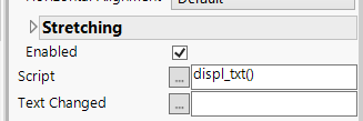

I call the function "displ_txt()" with the "TextChanged" script in the object section of the TextEditBox and tried the following in the Scripts Tab, but it does not work.

how about script:
whenever the users selects the text edit box and finishes there, script will be triggered.
Script seems to be slightly "ahead" of Text Changed:
When you place displ_txt() there, it already returns the new length once the user finishes the entry - not 1 step later.
Re: How to get a "Get Text Changed" functionality for a TextEditBox in a JMP Application?
Thank you for your answer. Unfortunately, my focus was to get the text without a commit. Thus, Script will not do exactly what I want.
