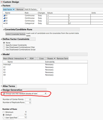

Note that depending on your need and intended design, it is also possible to generate random blocks at the end of design creation. This possibility is disallowed if you have defined one (or more) blocking factors :
Hope this answer will help you. If not, could you share more info about your design, goal, possibly the JMP file for the design you're trying to create, ... ?
