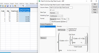

You can also add formula column as below;
-Add 1st IF = column sum if code not 0
-Add 2nd IF = display result only if code not 0
Result:
JSL Script (refer workflow builder / log)
Names Default To Here( 1 );
//Change column info: Total % (Col Sum Qty/Total Count)
Data Table( "dt1" ):Column 4 << Set Name( "Total % (Col Sum Qty/Total Count)" )
 << Set Formula(
	If( !:Code == 0,
		Col Sum( If( !:Code == 0, :Qty, . ) ) / :Total Count
//Change column format: Total % (Col Sum Qty/Total Count)
Data Table( "dt1" ):"Total % (Col Sum Qty/Total Count)"n <<
Format( "Percent", 12, 2 );
