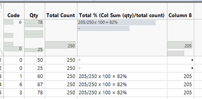

Hi all,
I have a column where I need to filter out some values to get the sum of columns (using Col Sum). Is it possible to get the col sum according to the condition? For example, every 0 code will be excluded from the computation:
CodeQtyTotal CountTotal % (Col Sum (qty)/total count)
050250-
025250-
160250205/250 x 100 = 82%
667250205/250 x 100 = 82%
378250205/250 x 100 = 82%
I tried using an If statement, but the code with 0 values still gets included when using the Col Sum formula

You need two if-statements, one to avoid writing values to Code = 0 rows and one to perform the calculation
If(Code != 0,
	Col Sum(If(:Code == 0, ., :Qty))

Hi @UserID16644
Conditional formula is a bit tricky in JMP.
As @jthi mentioned, you need 2 IFs.
You can also add formula column as below;
-Add 1st IF = column sum if code not 0
-Add 2nd IF = display result only if code not 0
Result:
JSL Script (refer workflow builder / log)
Names Default To Here( 1 );
//Change column info: Total % (Col Sum Qty/Total Count)
Data Table( "dt1" ):Column 4 << Set Name( "Total % (Col Sum Qty/Total Count)" )
 << Set Formula(
	If( !:Code == 0,
		Col Sum( If( !:Code == 0, :Qty, . ) ) / :Total Count
//Change column format: Total % (Col Sum Qty/Total Count)
Data Table( "dt1" ):"Total % (Col Sum Qty/Total Count)"n <<
Format( "Percent", 12, 2 );

Re: How to get Col Sum of a row in a conditional statement?
Maybe I'm missing what you're asking, but this might do what you want with a simple  Col Sum():
Col Sum( (:Code > 0) * :Qty, :Code > 0 )
":Code > 0" becomes 0 or 1 depending on whether it's zero or not, multiplied times Qty gives you the number you're looking for, then grouping cases where :Code >0 separate from the Code == 0 cases.
