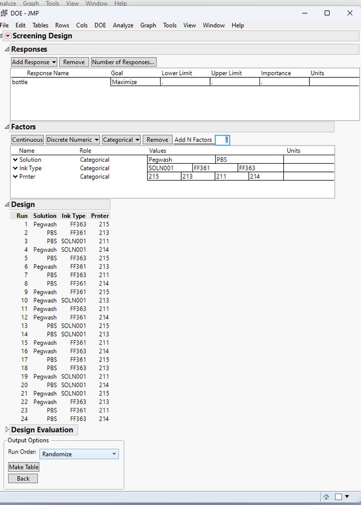

Hi @MedianPuppy4982 .  It May be helpful if you post your design so that we can understand the design better, and answer @Mark_Bailey ‘s questions. His questions are really about how you designed the experiment, and what your thought process(es) was.
MedianPuppy4982
Level III
Re: Understanding Fit Response Screening Effect Tests
I apologize for the delay! Thank your for trying to help! I have attached some screenshots of my design hopefully this will help
