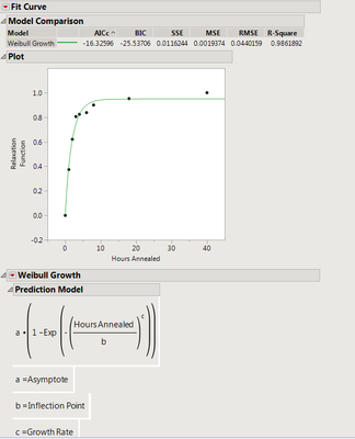

@Mark_Bailey is right. The Nonlinear platform is flexible and can fit any model you can parameterize in the Formula Editor.
Fit Curve and Nonlinear can work together since Fit Curve can save a parametric prediction formula.
So, after using Fit Curve to fit your Weibull Growth model you can save the parametric prediction formula. Use the Formula Editor to edit the formula and remove the exponent parameter (set set it to 1).
Then use the Nonlinear platform with your original column in the Y role and the new predictor function column in the X role.
Click the Go button at the top of the report and you'll get estimates for the a and b parameters.

Thanks, I checked out fit curve and it looks like Weibull Growth is actually closest to what I want, but not exactly. Is there a way to force a variable, say a, to equal 1 so the equation matches what I'm looking for. Then the second equation I want to fit would have a and c equal 1.

There are two platforms for non-linear models. Fit Curve is newer. It is based on a library of such models. If your model is one of them, then it is probably the best platform. The Nonlinear platform, though, has the advantage here because you can specify a custom model as a column formula. You can also manipulate the parameters during and between fits.
See JMP 14: Help > Books > Predictive and Specialized Models > Nonlinear chapter. There are lots of examples, too.
