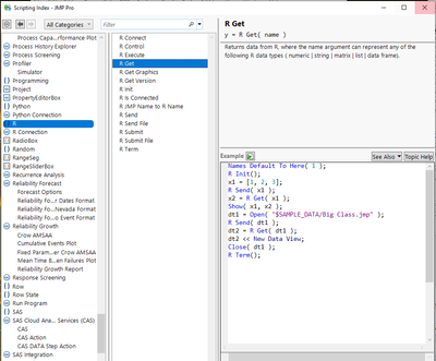

If you go to the Scripting Index under the Help pull down menu, you can then scroll down to the R entry and see all of the commands available.
The
R Get()
function is the one that retrieves objects from R
More detailed information can be found in the Scripting Guide, available in the JMP Documentation Library, also available under the Help pull down menu.  Look in the section on Enhancing JMP
