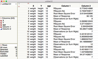

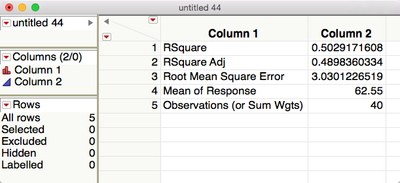

You can convert any table in a report into a data table by right clicking on it and choosing Make into Data Table.
If, as in your case, you have lots of analyses in your report window, you can choose Make Combined Data Table which will make one data table that combines all the tables like the one you click on.
