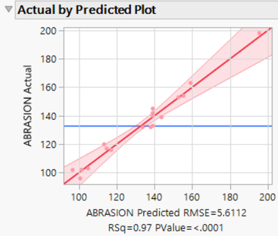

I wan to draw a graph like the first pic, but when I have 3 variables in a new model, my graph looked like the second one. How do I draw multiple lines?

Seems that you want to see a regression (actually: multiple, like in the graph on the left) - and you wonder why you don't see them in the plot on the right. The plot on the right is something different - please note that the "same" values are on the x and y axis: It compares Y values with Y values -  the predicted values with the actual "y' values (actual vs. predicted plot).
For a regression, one puts a an effect on the x axis and the actual values on the y axis. Then one can add the model fit and compare the regression with the actual values.

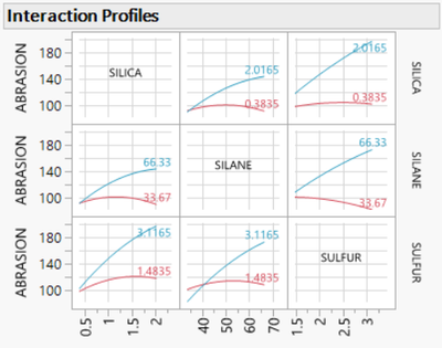

To see multiple fit curves in Fit Model, together with the raw values, you can use the prediction profiler and activate "raw values" and Interactions, as it is explained in Prediction Profiler enhancements in JMP® 18
Maybe going beyond what is needed here:
If there are multiple effects, and there are interactions [the influence of one effect changes depending on the setting of another effect], it's not enough to look at a static graph with a set of fit lines.There is a complicated interplay between the effect. This can be visualized in different ways:
  • best: Prediction Profiler
    the user can choose specific settings for every effect and check the influence on the fit result.
    it is cool, it is interactive. But sometimes the user wants to see the interactions in a static plot.
    Therefore, in JMP18, Prediction Profiler got the above mentioned enhancements ...
  • they came from: Interaction Plot
    the idea: plot several curves that illustrate the interaction caused by variations of the other effect. Display the interplay in a Matrix.
    Surprisingly, there is no universal definition how the curves are created (based on the fit or based on the input values). Therefore the curves in interaction plots can look completely different depending which software is used: JMP, Minitab, Cornerstone, JMP)
     Creating two factor interaction plot (without the full matrix profile)
    This is how an Interaction Plot looks in JMP:
  • As mentioned above, in Prediction Profile  - in addition to the interactions, you can now add raw data points to the plot.

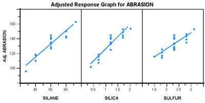

    There is a third plot type which tries to fix this issue. It corrects the position of the data points by adjusting the y values according to the fitted interactions:
    Adjusted Response Graph   (https://www.google.com/search?q=adjusted+response+graph+ )
    This plot type is not available in JMP, to get such a plot please use other programs like Matlab or Cornerstone.
